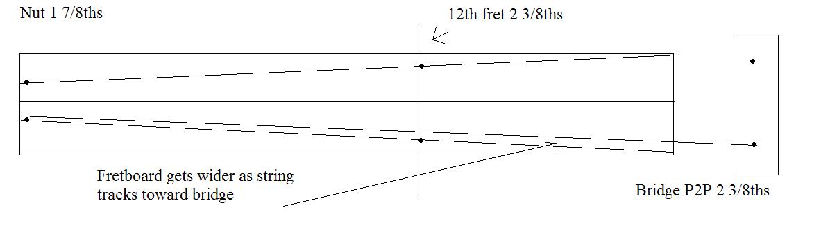

I do it the same as Paul. I will make the width of the pin to pin the same as the fretboard at the
12th fret. I also do as Colin said, build to the preference of the client. My last OM was 1 7/8ths nut and
2 3/8ths pin to pin at the bridge. So to make the fretboard, I first found my center line, then marked the
nut width, then moving up to the 12 fret, I marked out the 2 3/8ths then connected the dots for a proper
fretboard taper. What this does is allows for a bit more wiggle room up the neck where the strings are looser, and
helps to prevent the strings from falling off the edge of the board.
Mark Blanchard actualy gave me this tip while building my 2nd guitar and I have used it on every one since.
Below is a quick and dirty graphic.
